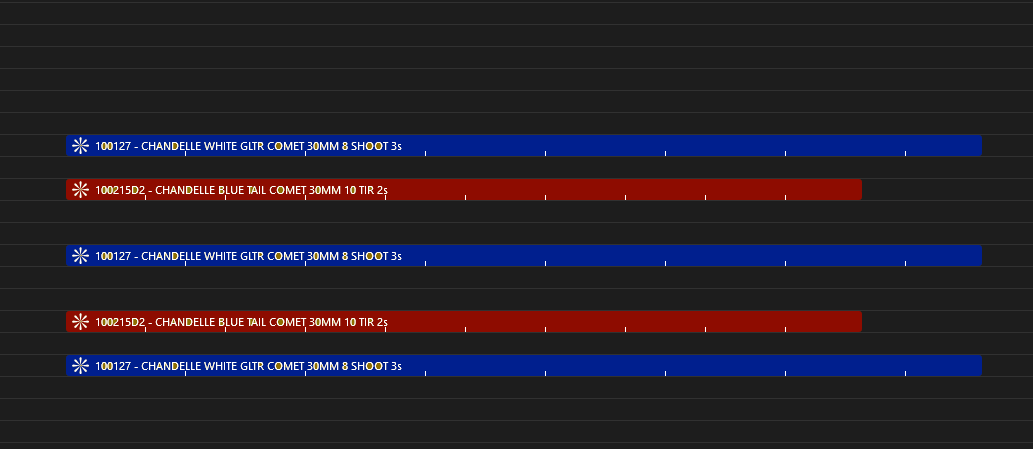

  • Motorized Stars - Albeit this function may potentially be coming soon, there are some workarounds to make motor mines by making a cake and exploiting the shell rotation feature to create the effect. Another effect is by using the shell of shells as if it was the main effect, and then each subshell is a single star one, which should have the same size of the parent.
