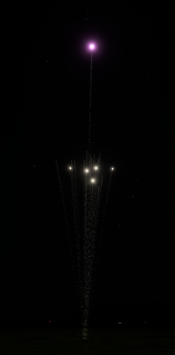

i use black tail with small particle for stars and ascent effect

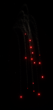

To create any kind of effects as those below follow the next steps:
Falling Leaves:
Silver tail:
Start 0%, End at 100%. Amount of sparks 30, Width 1,0. Type β†’ Microstars small.
Spark duration 5,95 β†’ Burn duration 76% β†’ Particle size 1,50
Shells:
Silver tail:
Start 0%, End at 100%. Amount of sparks 50, Width 0,1. Type β†’ Microstars small.
Spark duration 1,25 β†’ Burn duration 18% β†’ Particle size 1,50
Comet:
Silver tail:
Start 0%, End at 100%. Amount of sparks 55, Width 0,3. Type β†’ Microstars small.
Spark duration 1,00 β†’ Burn duration 20% β†’ Particle size 2,50
Mine:
Silver tail:
Start 0%, End at 100%. Amount of sparks 50, Width 0,6. Type β†’ Microstars small.
Spark duration 1,50 β†’ Burn duration 33% β†’ Particle size 1,50
Ofcourse depending the effect and the amount of stars it will effect your smoke desnity.
So play a bit with those, also dont make the Particle Size bigger since it can be unrealistic and becaume more a glitter tail then smoke,
Watch this show so you can see how the smoke reacts.
