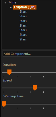

Play with the speed to get the hight and duration is just duration, should be fine then

I guess it is going to take me a while. I also wish my screen looked like yours. I go to tools, effect editor, select mine, and get nothing like your screen shot. lol

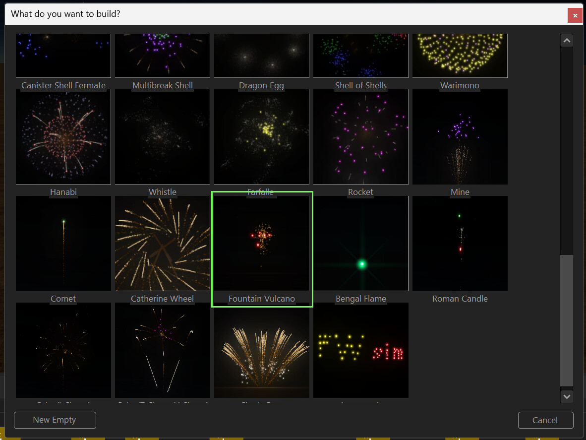

Hi Frank,
welcome to the FWsim community forum!
When you open the effects editor, select this template. It builds a fountain for you:
Then, click View → “Show Effect Dimensions” to show the height.
Finally, click “Eruption”. There you can adjust the speed (to get the right height) and the duration.
Hope that helps! If it’s not giving you the result you like, feel free to post a video of the real effect. Then we can give you more precise instructions.

Thanks! I believe with the method from my previous post you will be able to build something similar. Let me know how it goes and if you need any help.
