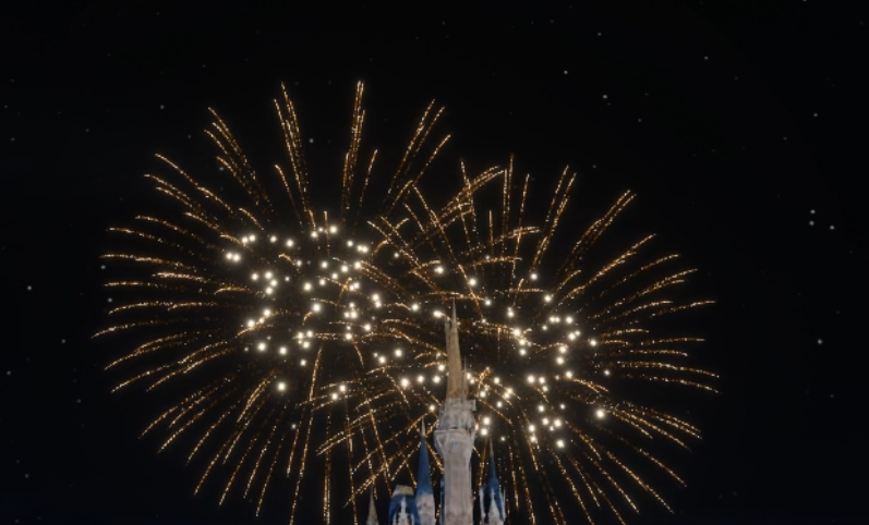

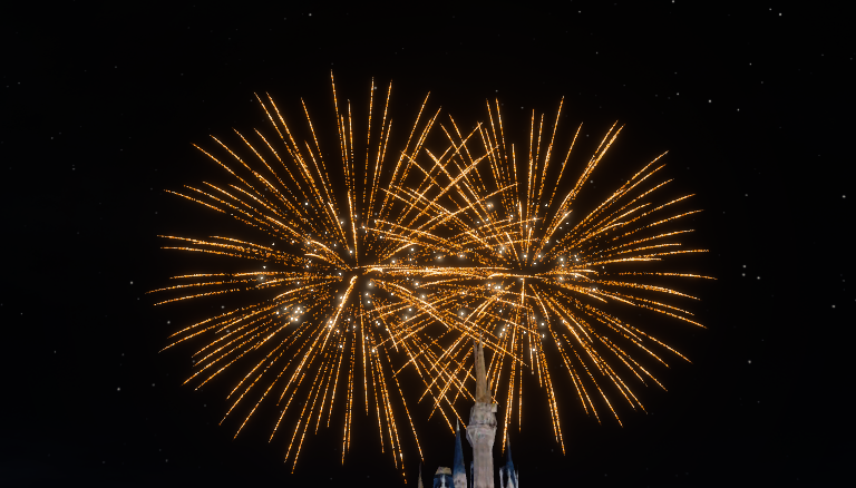

I do like how the stars look now. However, this update kinda ruined my shells as the color of the firework tails are different now, especially with the microstars. Here is the comparison of the 2 versions with the same shell,
(Before)
(After)
Is it possible to revert to the previous state in the next update?

Thanks for sharing that comparison. Can you send me the effects file via private message? (You can find the effects file in Documents > FW-Sim).

We made some slight changes to the star sizes. Things should look mostly like before, but there might be differences. If you have an effect where you see a large difference, send me the effects file via private message and I’ll have a look.

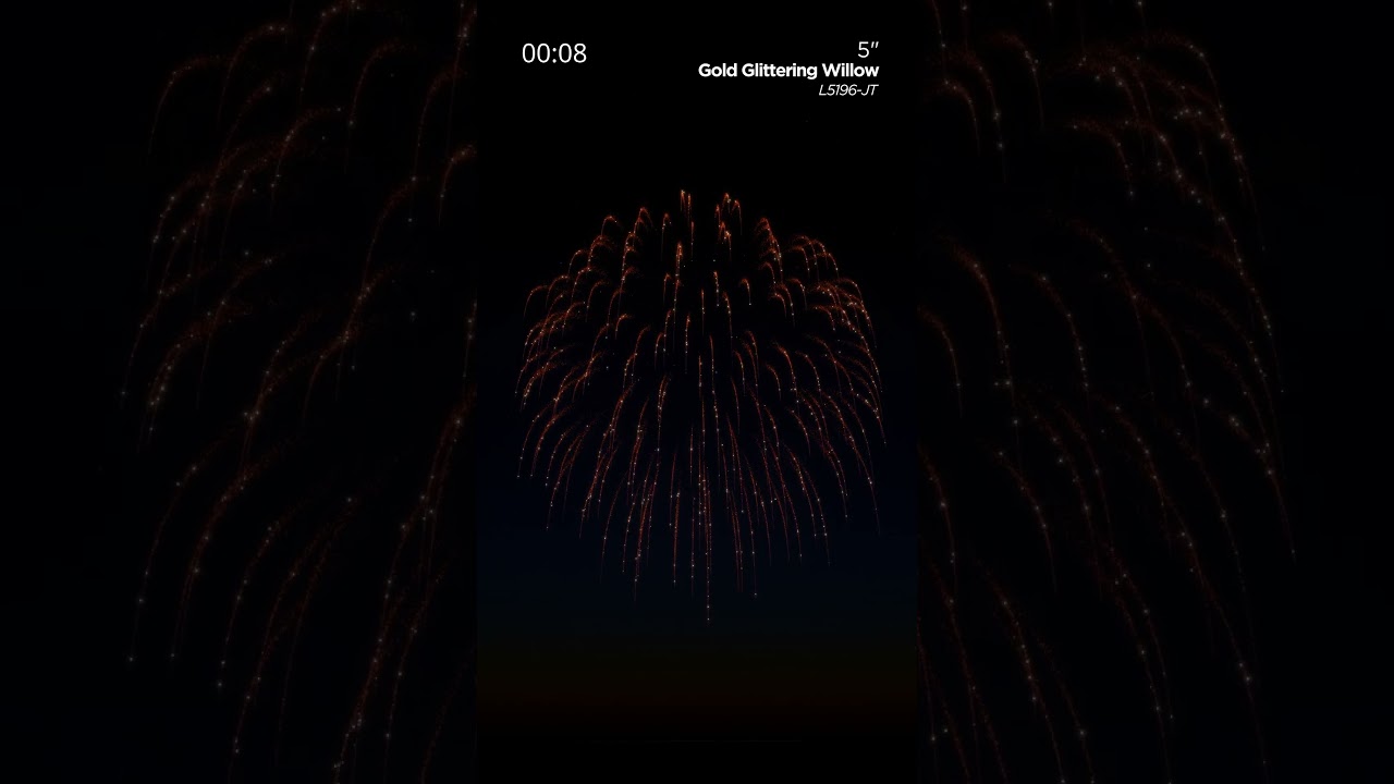

Hi. I saw this video, and this effect that the tails was cut and didn’t appear in the last few seconds of the tails.
Please help by fixing this.
Aaron
Hi Aaron,
thanks for reporting. Please open the show file that created this video and click Help > Send Show file to support. I’ll have a look then!
