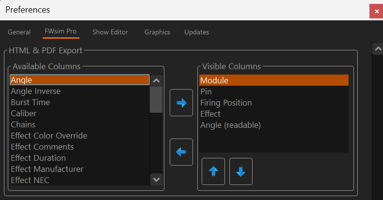

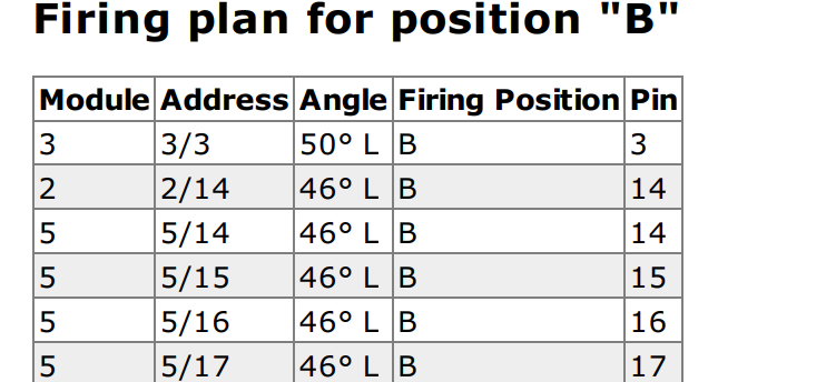

Hi i a m trying to get a printout that shows what pin,mod, position the name of the effect and the angle for example
Page 1
Mod Pin Address Angle Firework Name Firing Position
1 2 1/2 40 L 20mm Comet A
Page 2
1 2 1/2 40 L 30mm Comet B
But all i can get is this and then a list of how many of the effects are used
It would really be helpful if the names were include in the first part instead of hoe many at the end. I am trying to set up single shot angle racks. is there a way to do this?
