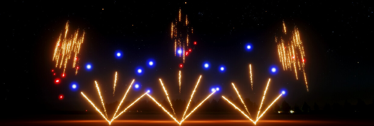

Otherwise here another example, evrything what is blue is gone in the latest version.
It wasn’t in the version before the latest version.
It’s also gone in the firework edite.
