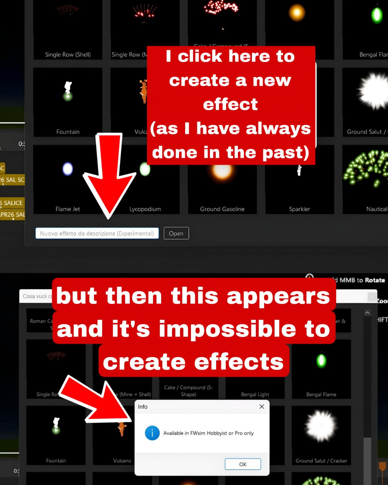

Hi, I have an issue when I try to generate new effects. As you can notice from the picture, before I updated FW Sim to the 4.3 version, it was all okay when I had to create effects. Now that I installed the 4.3 version, when I open the menu with all fireworks effects and want to create a new one, it says: “New effect from description (Experimental),” a function exclusive for Hobbyist and Pro, while I have the basic plan. My question is, how can I fix this and keep creating effects by myself? Hope someone can help me. :slight_smile: Thanks.

In 4.2, there was a button “Create New Empty”.
We have removed this button. Instead, please click one of the thumbnails above to start from a preset. This ensures that your effect has the correct Type and Subtype information stored - so FWsim can set up proper, realistic scaling depending on effect type.
In the same location as the “Create New Empty” button there is now a new button to create an effect from description (the new FWsim Effect Generator). This is a new 4.3 feature and it is not available in FWsim Basic.
