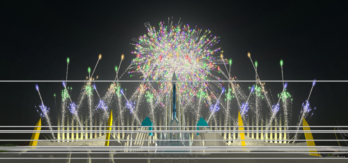

Here is an sample screenshot image from the main editor showing one of the brightest parts of my show. This used to be much brighter and the “height” of the bengal flame was much lower as well. Keep in mind, the 3D Models in the show are not mine; they’re modified designs from the sketchup 3D warehouse. Background is a screenshot of my theme park in NoLimits 2.
Got it!
Have you tried using the configuration option? Can you get your preferred look by using it?
