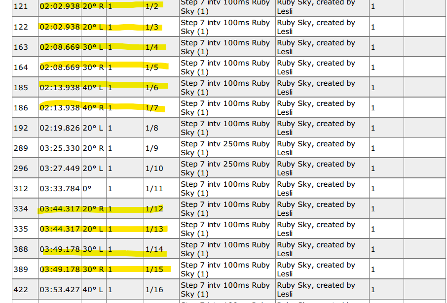

Multiple events on the same mod at the same time on one pin
Is there a way to combine a couple of fireworks that are on the same mod at the same time to a single pin? I cant find a setting anywhere to fix this and im loosing several ques per mod that could be use elsewhere in the show.
please try this:
  1. Select the cues you want to put on the same pin (in your case, it’s two but it could be more than two). You can select them by drawing a rectangle, or holding the SHIFT key.
  2. right-click and select “Chain Cues”.
That way, both cues will be put on the same channel.
Thank you. I should of explained my self better. I was meaning to ask if there was a setting to do it automatically when i hit the Auto- Assign-Channel. So i don’t have to go through the script and manually do each one?
Let me check that for you. In order to give the best possible advice, could you let me know which firing system you are using?
(The procedure is slightly different depending on your system)
I am using cobra. I can send you the file when i get home. Once i chained them it would not let me export the script saying that you cant chain sequenced events.
Thanks for the clarification that you are using Cobra. We will run a few tests on the Cobra system and get back to you with an answer, on how you can combine your shots automatically.
You also mention that you have trouble with the Export, when sequenced events are chained. Can you send me your show file in private message? I’ll have a look and let you know.
