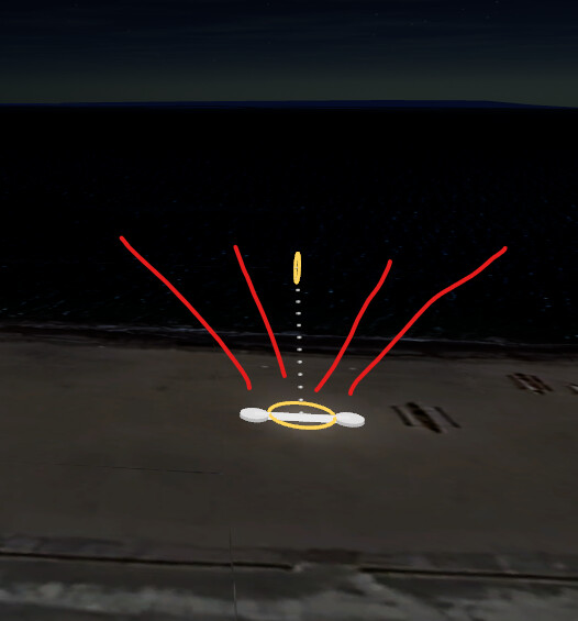

Hello, Newbie here, using the FW Basic.
I have used google maps scenery and I can’t position my cakes properly, into left to right angle, it only shows me “Z axis” rotation.
The front/back angle feature is only available in Creative Edition.
In Real Location dialog, there’s a Orientation slider to rotate the Google Earth scenery:
Position line from left to right
Hi @silencio ,
and welcome to the FWsim community forum. @fy1vo51 has explaind it: When you load a 3D map, you need to make sure that the orientation is correct, so that left/right works as expected.
In your case, it looks like you need to enter an orientation of 90°. This will make left/right work correctly from the audience perspective.
Let us know if that helped!
