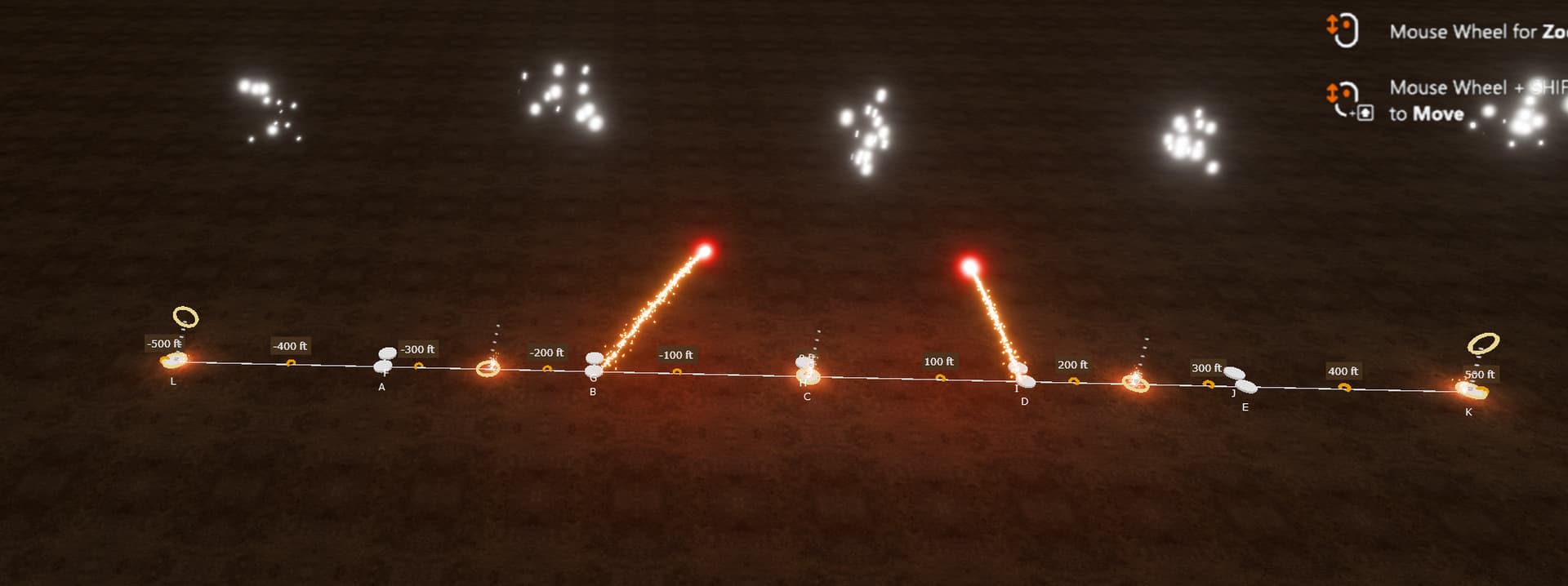

i have 7 front positions when doing a sequence effect with 5 shots i place them like in the picture and not on the positions unless i use 7 shots. there is no way to move them also.

yes and no. when i do it that way the angles are all off and cant be fixed
Ok, thanks for reporting back. Could you send me your show file through private message? I’ll take a look and let you know exactly how to solve this.
