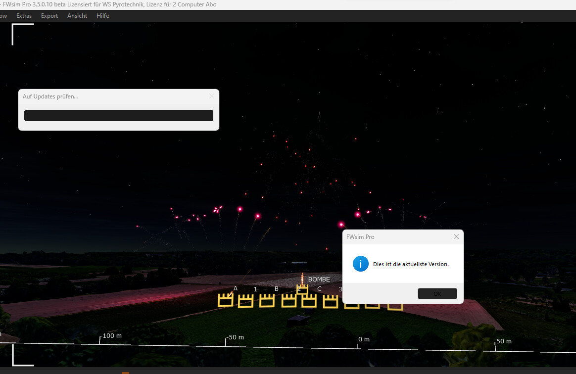

ok, fwsim update says me, i have the neweset version 3.5.0.10
Please try clicking Help → Check for Updates. FWsim should then update to version 3.5.0.12.
thats what im doing, but it says i have the newest version.
My apologies! We didn’t release the update for FWsim Pro Beta yet. It will be available shortly, please check again in half an hour. (edit: The update is available now)
